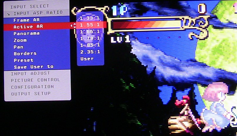

As with the DVDO Edge, you may find you need to apply a little zoom to the image to get the perfect aspect ratio. This is especially true in line triple mode, where the 240p test suite shows that the image is a little vertically squashed. The VP50 Pro has extensive zoom/pan controls and complete aspect ratio controls, meaning you can apply a little zoom or choose from an aspect ratio preset that best suits the game you’re playing. On my setup, I’ve found that a vertical zoom of 1.075x corrects the vertical size of the picture perfectly in Generic 4:3 line triple mode As of the newest OSSC firmware, extensive adjustment like this shouldn’t be necessary.
If your game doesn’t draw anything in the borders, you can choose a different aspect ratio that hides these parts but zooms the content you are interested in, or just manually zoom the image to your hearts content. As with the DVDO Edge, of course, you want to be careful not to zoom or manipulate the image in such a way that results in very uneven scaling. Particularly if you are using scanlines, stretching out the image can cause one or two scanlines to be noticeably thicker than others. DVDOs scaling engine is very good in this regard however and usually the image is acceptable no mater how you abuse it. Again, the 240p test suite is an excellent tool to use to check for problems, particularly now it has the new vertical scrolling test too.
The units aspect ratio and picture controls are extensive.
Note that even with the Zoom/Pan controls, line triple mode on the OSSC has a tendency to cut off part of the image on the right hand side with some sources. The Megadrive is particularly vulnerable to this. Only a few pixels are lost, so it usually doesn’t matter and a feature to correct for this on the OSSC is planned for a future firmware update.
Once you’ve done calibrating the image you can save the aspect ratio and zoom settings to one of the VP50’s presets. Input presets are per resolution and per input, so you can save up to 10 for the OSSC without worrying about overwriting any presets you might need for other inputs. The VP50 Pro will remember the last used preset, meaning when you switch between line double and line triple, your preferred zoom and aspect ratio settings will be recalled automatically.
