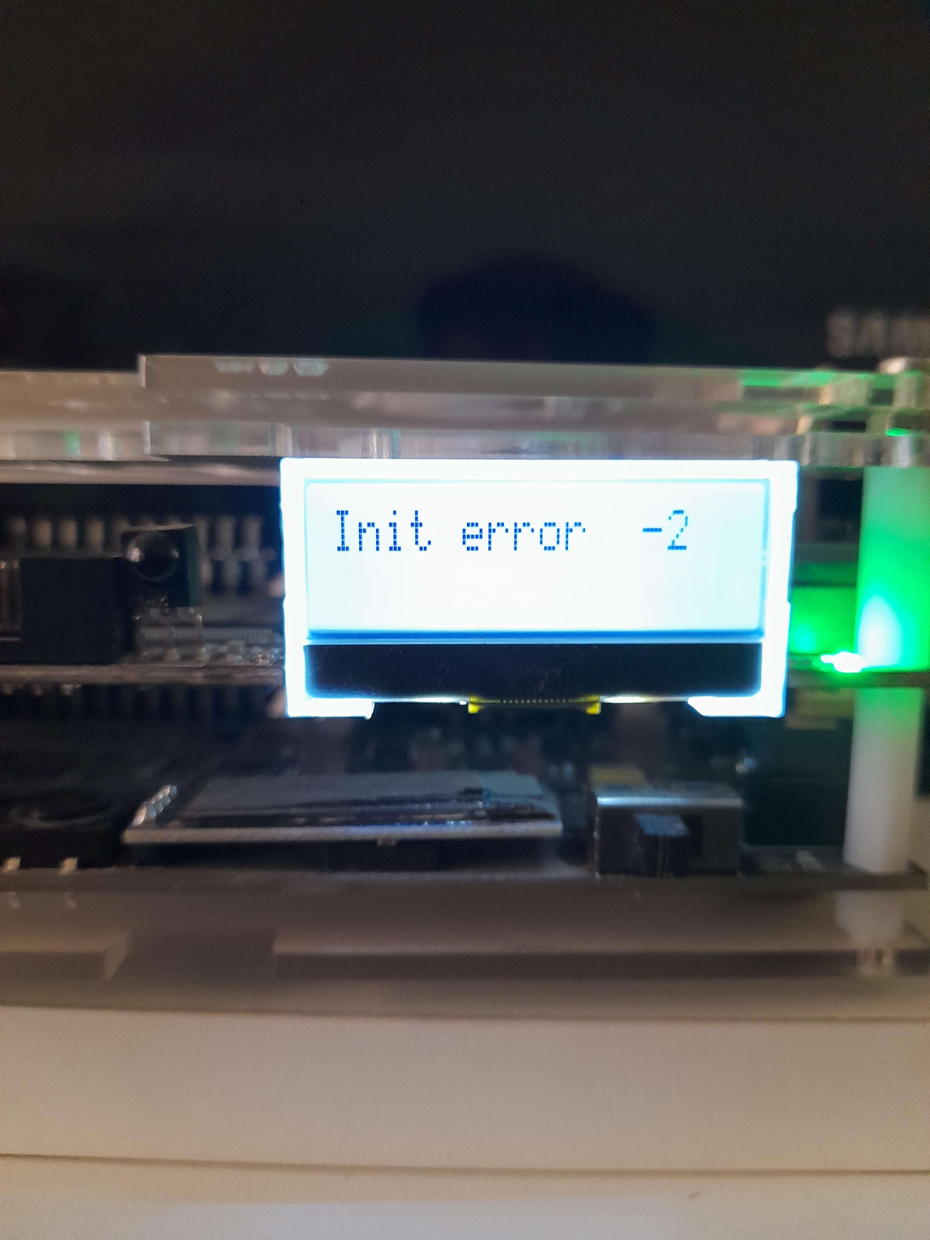

      Hi, I bought this OSSC a couple years ago from retrogamecastle on aliexpress. A bit after I bought ossc add on bitfunx board (a complete waste of time and money by the way, but it the ensamble looks nice). It has worked perfectly until now. I started getting this error (Init error -2), the first time the ossc booted correctly after a power cycle, but the next day it only shows that message and nothing else, I’ve already tried multiple power sources that should work and I get the same message, so it isn’t that.

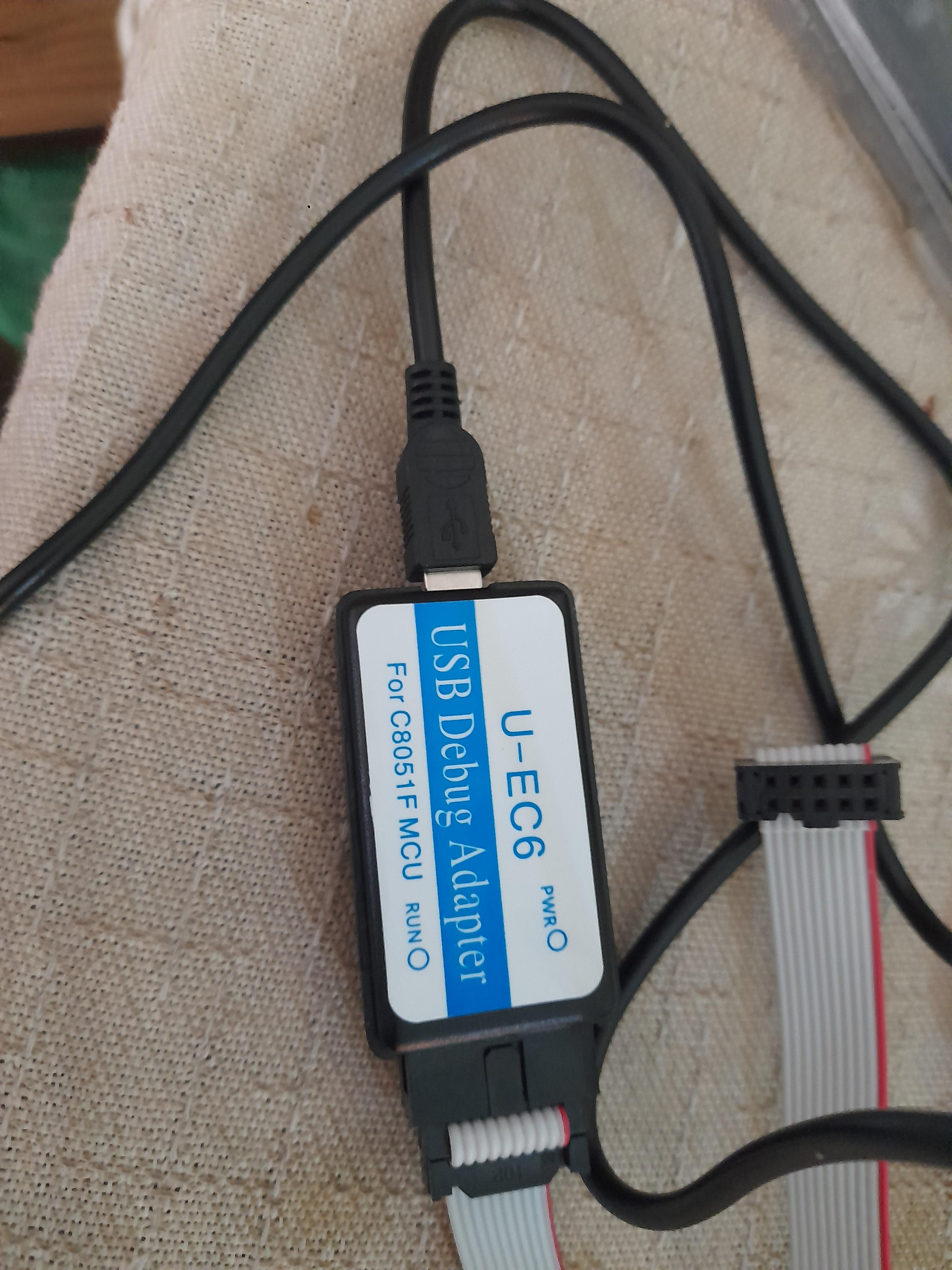

      I don’t have a usb blaster, but I could get my hands on this thing, anyone knows if this can work for a firmware re-install? I really want to fix this since it seems like a simple problem but I have absolutely no programming knowledge sadly.

        “Init error -2” means I2C communication with THS7353 chip failed. It’s also the first I2C slave checked so the issue might also be damage in some other chip which drives I2C line(s) low.

          #65278
          Morpheus_79
            No. Why? You can try to replace the THS7353 (U17). It’s available from LCSC, Mouser, DigiKey and other suppliers:
            https://www.lcsc.com/product-detail/Video-Amplifiers_Texas-Instruments-THS7353PWR_C2652733.html
            https://mou.sr/43rSQvO
            https://www.digikey.com/short/n19p40zd
            … and costs around 5 bucks. If you don’t know how to replace it yourself, you can try to give it to someone who does (a friend or a repair shop).
            As ‘marqs’ said: there could be something else broken… but it’s a good starting point and it doesn’t cost the earth.
