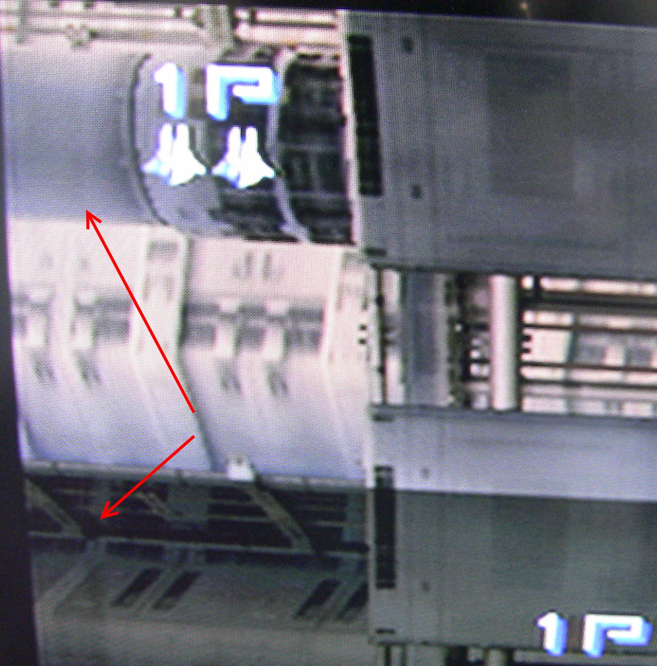

A faint band of discolouration can be seen on the left of the image.
While picture quality was generally excellent, it’s not quite perfect. On the far left of the screen there’s a band that’s slightly discoloured compared to the rest of the image. It’s definitely not a deal breaker in our opinion but nevertheless worth pointing out. This band was present when we checked the image using the DVDO Edge and XRGB3 scalers too, though we’ve only tried one PS2 console (a PAL fat model with a O2 modchip and a luma for sync RGB cable). Update – We’ve been informed from other users that it affects their PS2 consoles too in the same way. We’ve tried to illustrate the problem with the digital camera shot on the left. You may need to click the picture and zoom in to actually see it.

      I don’t think there are any bugs in the unit? Are you referring to the banding, because that’s just as likely to be down to the Playstation as anything else. I have an Extron and a Sync Strike too but cabling it all up to compare would be a bit of a hassle, I’ll get around to it sometime though.
