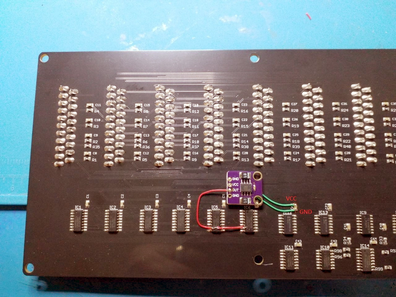

1. IC5 and IC6 Replacement & Buck Convertor Installation
Examine the above image and locate IC’s 5 and 6
Using SMD rework tools, remove both IC5 and IC6, these will be replaced with uprated versions of the IC.
Before soldering the new IC5 and IC6 components, lift pin 7 of both IC’s, ensuring they are clear of the PCB pads.
When soldering the chips into position, do NOT solder pin 7 on both IC’s. Ensure these 2 pins, one on each IC, are both kept clear of the PCB.
Fit the buck convertor in place using a suitable insulated fixing method and wire up as shown in the photo above using Kynar 28 awg hookup wire.
Ensure there are no shorts between VCC and GND before connecting power.

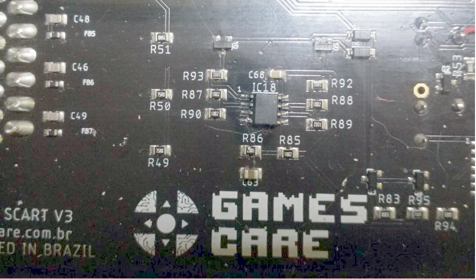

2. Op-Amp Replacement
Locate and remove IC18, fit the new OpAmp in place.

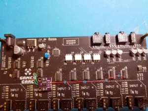

SCART Switch Expansion
The following image depicts the different component locations compared to the main switch unit.
The circuitry change rework is identical to the main switch unit, apart from there being no op-amp replacement required.

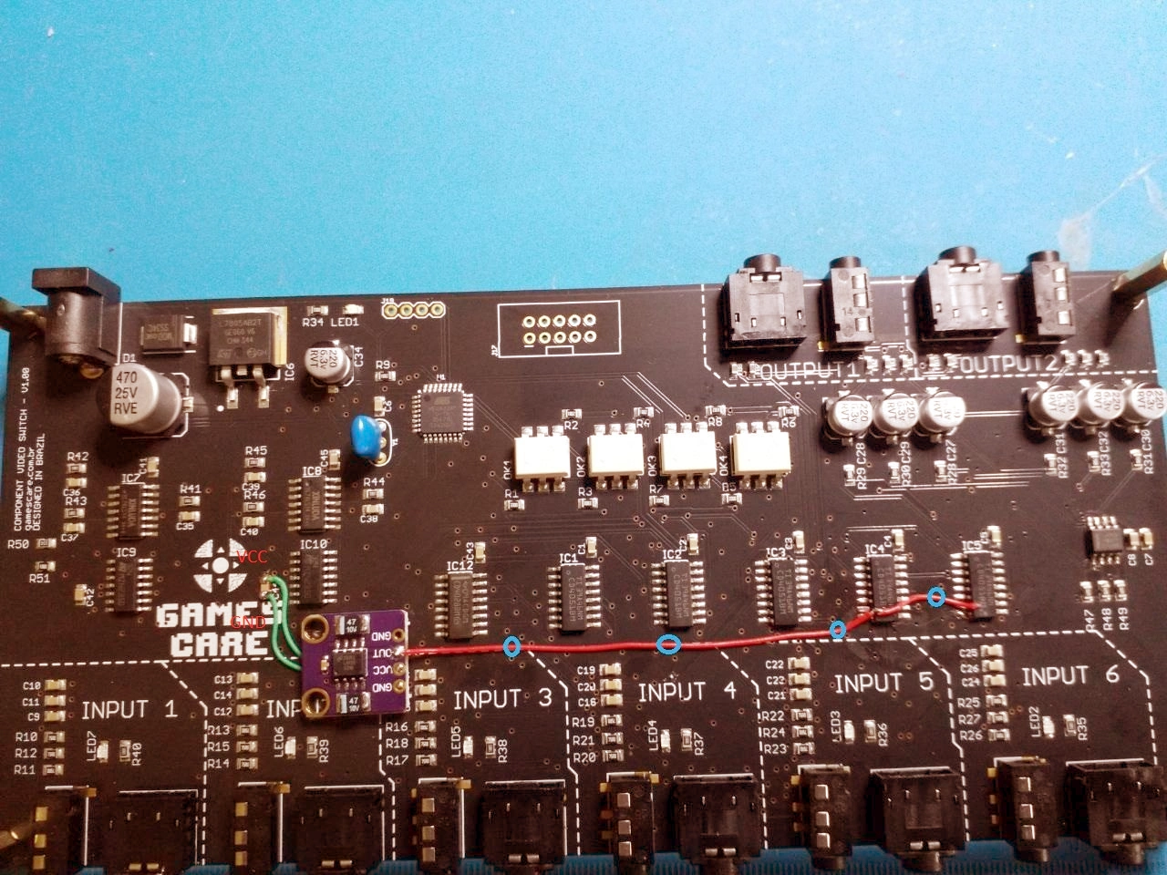

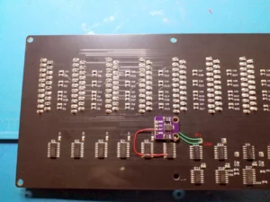

Component Switch
The procedure is largely the same as the SCART switch apart from:-
- The modification is carried out on the top side of the board.
- There is no op-amp to be replaced.
- IC 4 and IC 5 are only to be reworked and not replaced.
Using suitable rework tools, pin 7 of IC4 and IC5 must be carefully lifted ensuring that they are clear of the PCB pads.
Once the wiring has been completed as shown above, it is highly recommended to use some Bostik Fix and Flash, or similar glue, to secure the wire to the points circled in blue in the above photo.

The images are a little blurry. The instructions say to lift pin 6, but in the images it appears pin 7 is lifted and connected to the wire. Is it pin 6 or pin 7 that should be lifted? And to which pin should the wire be soldered to?
Thanks for that! You are correct, it’s pin 7, I’ve updated the documents.
