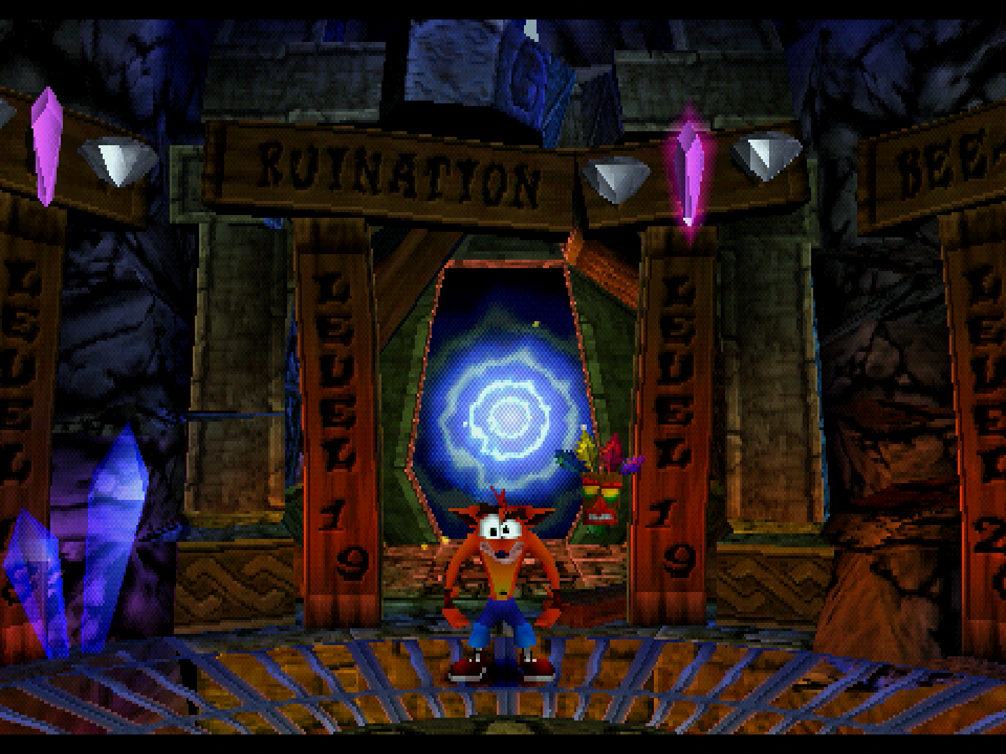

      After looking through the resolutions that the OSSC can output for 384×240 optimised, I noticed that 6x is scaled to 2304×1440 (6x on both horizontal and vertical), even though 1920×1440 would’ve been possible (5x on horizontal and 6x on vertical). I don’t know if this is just an oversight, or if there’s a technical reason, but would it be possible to change this in a firmware update? As I feel this is a missed opportunity to get an integer scaled 4:3 aspect ratio without having to squash/stretch the image.
      384×240 scaled to 2304×1440
      384×240 scaled to 1920×1440

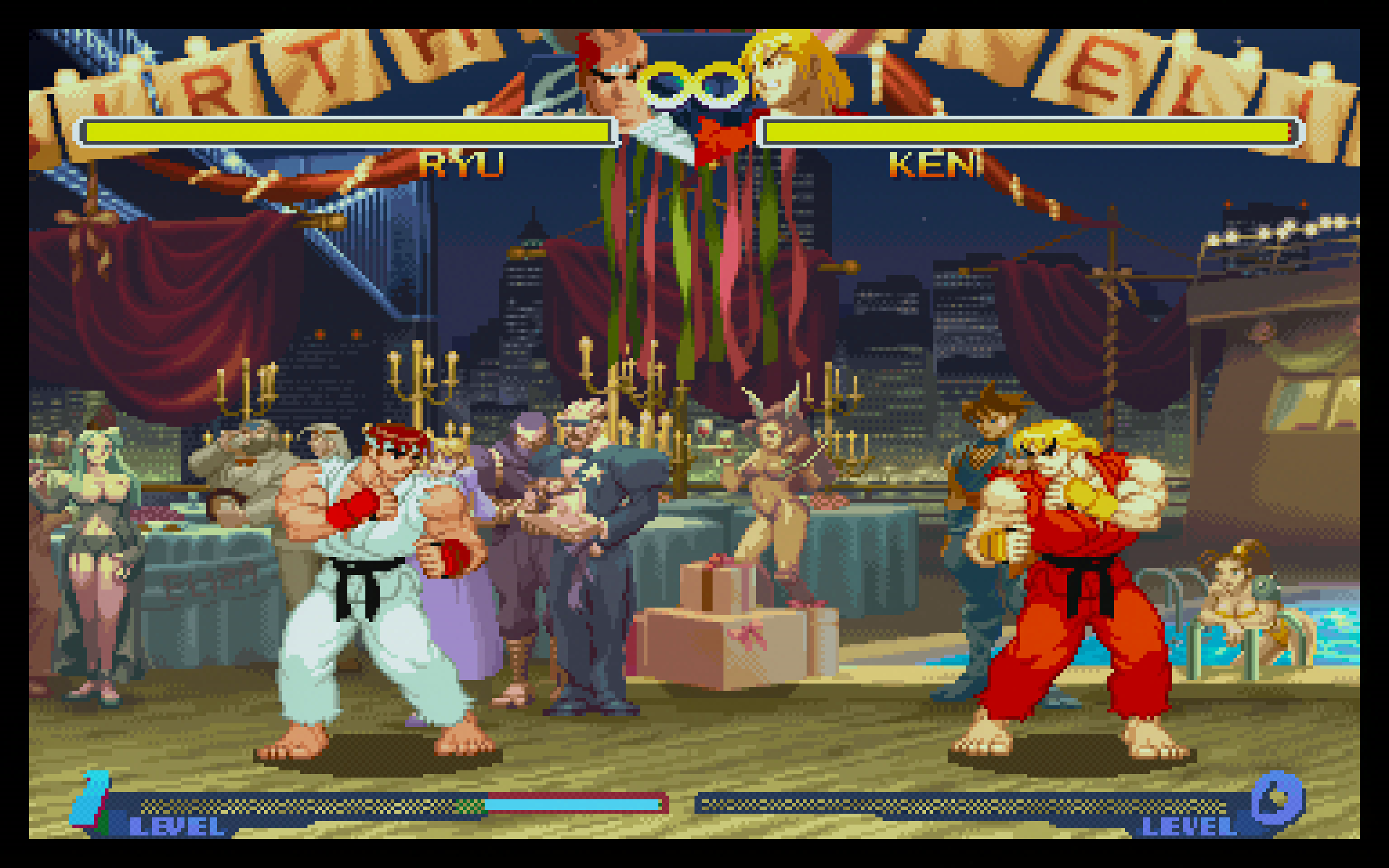

          Speaking of PAL, I recently found out that I can 4x scale 480×270 (512×288 cropped) to 1440×1080 (3x horizontal and 4x vertical) by using the 384 optimised mode, which gives me an integer scaled 4:3 aspect ratio. Whereas, the 512 optimised mode can only 4x scale 480×270 to 960×1080 (2x horizontal and 4x vertical), which doesn’t work. This is why I think having control over the horizontal multiplication would help in instances like this.
          Here’s a screenshot I took showing a 512×288 game at 4x using the 384 optimised mode:
