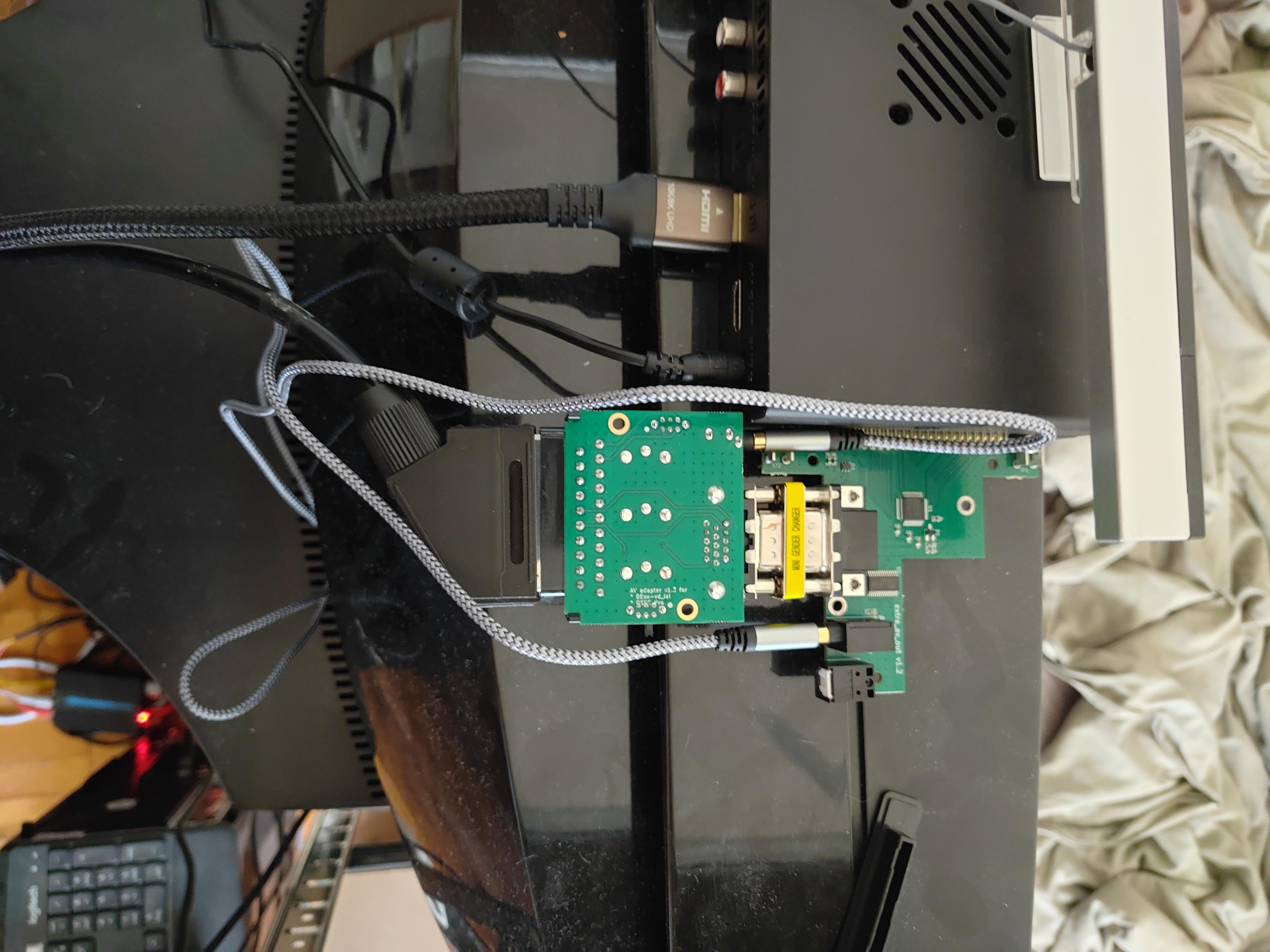

          RainerLeuteritz
            I input from hdmi input
            Than from the extra AV out the aux cable to the adapter

            RainerLeuteritz

                Is the HDMI source outputting LPCM 2.0 48kHz? In case it’s not visible/selectable, you can try selecting EDID for Pro that indicates support for nothing else.

                  #69612
                  Kekstier
                    I think your audio jack contact was not correct in… i had the same experience, the 3.5mm audio jack plug have to pull well in the socket of the 3.5 mm jack, when not: no audio!
