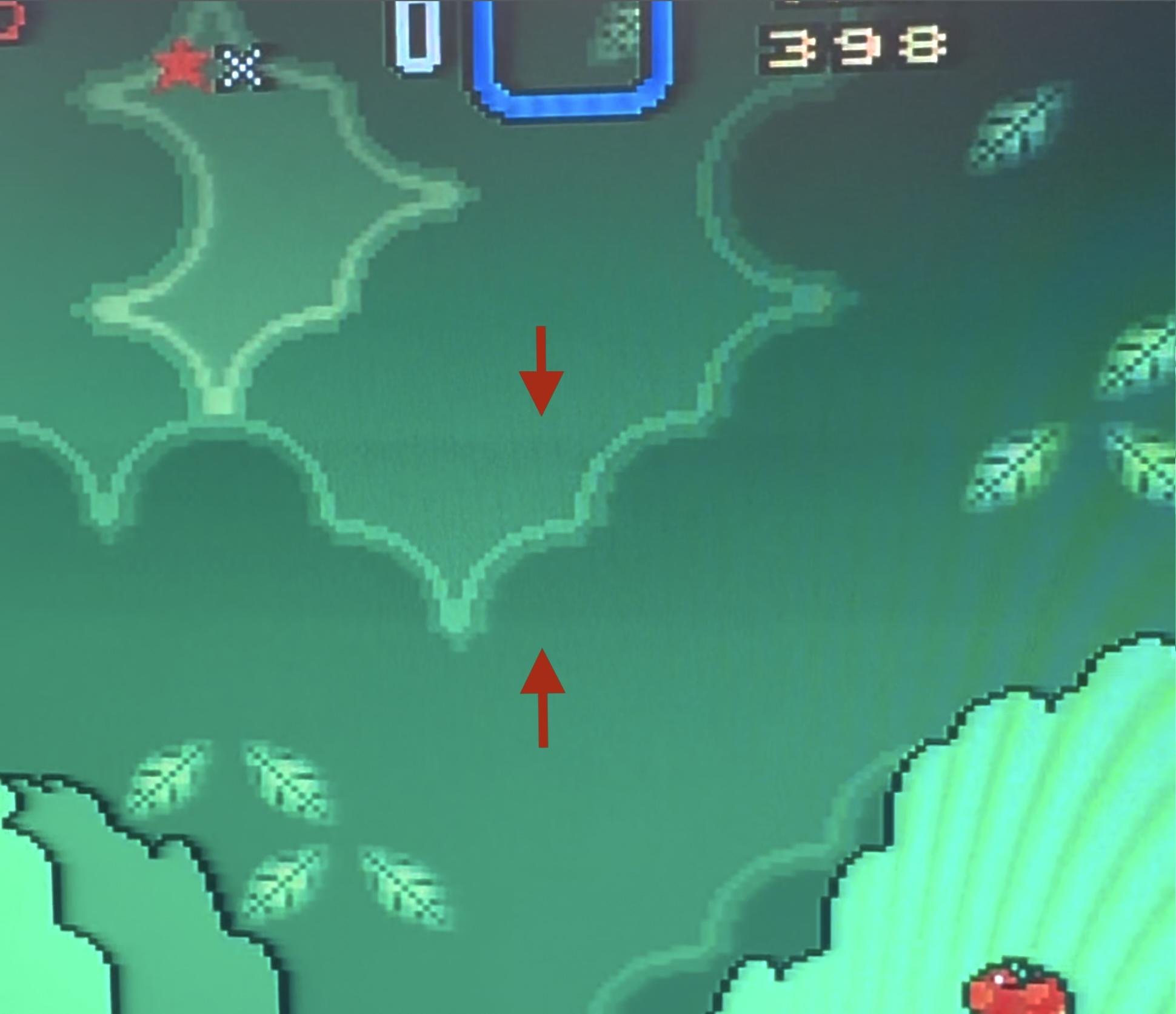

      Hello, I recently received the 8 in 2 out GameScare switch and while it does power on, I’m seeing severe video noise when using it.
      My setup was previously just using an OSSC (also bought from VGP) which had no noise issues on neogeo/SNES/MD. When I added the GameScare switch and a RGCUK 0.5m shielded SCART cable though, it does sync, but there are these flickering horizontal bars of noise added to the output. All consoles show the same issue. Both the RGCUK shielded cable and a cheaper SCART cable show the same issue.
      I believe it is coming from the WiFi antenna on the GameScare (ESP32?) based on these observations:
      1. The noise gets much worse while loading the WiFi menu.
      2. The noise goes away when I cover the antenna with my hand. Noise immediately comes back when I stop covering the antenna.
      I don’t see a way to disable the WiFi so it seems stuck with the noise. Is there anything I can do in terms of troubleshooting or is the switch defective?
      Below is a photo where I tired to capture one of the rapidly flickering noise bars. Notice how it’s darker than the surrounding image. It looks much worse in motion.
      ”Horizontal

        Did you already e-mail in about this issue? The GamesCare switches have had WiFi for some time, so I’d have expected this to have been more widely noticed if its not an isolated issue.

        TheCorfiot
          Unless you have a steel plate in your hand then your hand position is irrelevant to the WiFi broadcast dispersion.
          This does however sound like a grounding issue, ground loop or a fault with the ESP32 controller on the switch.
          The band image on the screen is a low frequency 50Hz Hum bar…
          WiFi frequencies at 2,4GHz are beyond being displayed by video amplifiers which at best cut off around 20MHz bandwidth.

            We have confirmed a fault with a number of SCART switches from the batch dated 8/26. If your switch has the following sticker on the underside and it is exhibiting these symptoms, please get in touch with us.
            gamescare switch sticker
            The cause of this fault is so far undetermined. All other switches from other batches are unaffected.
