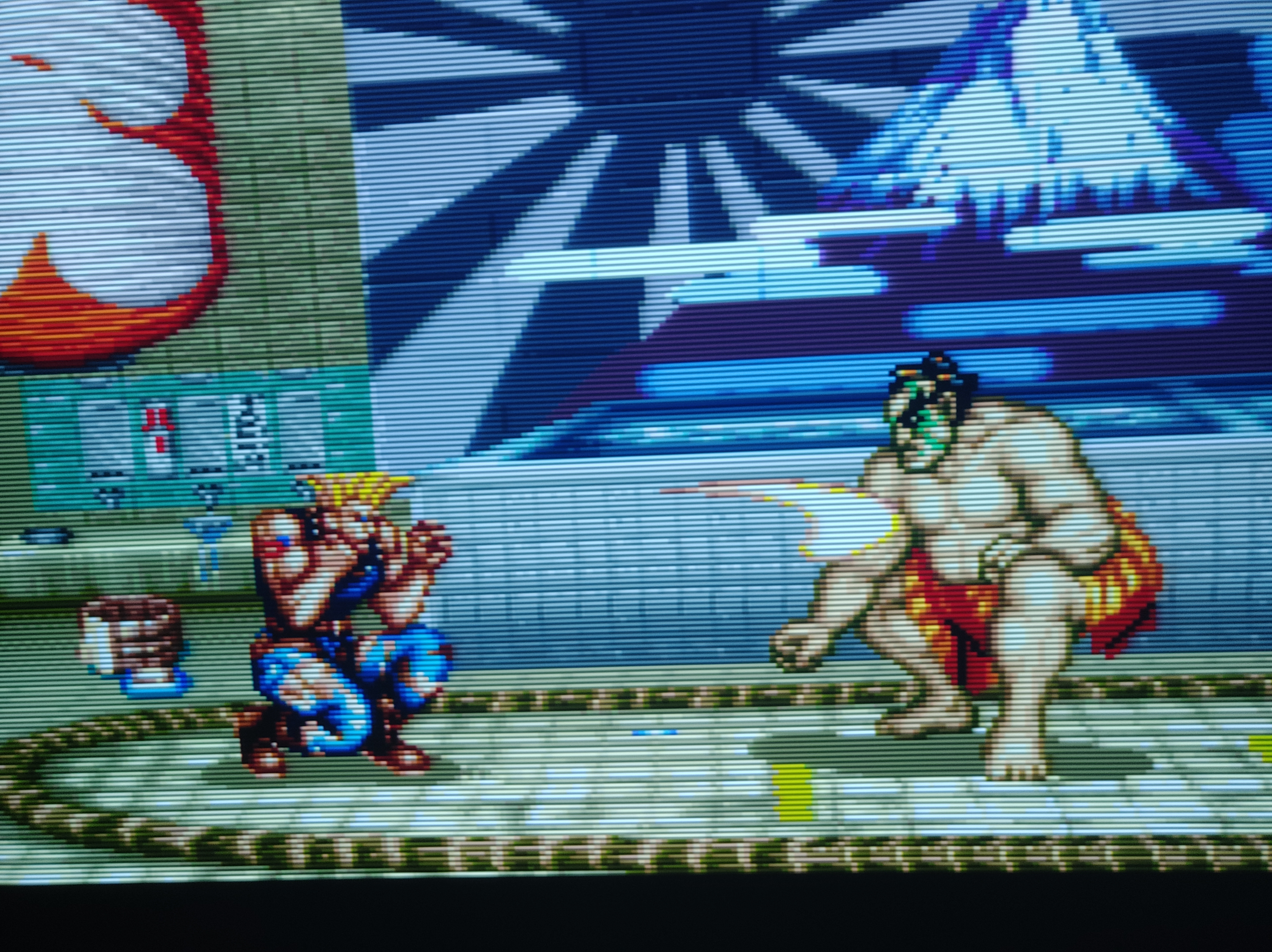

              Non-integer scaling of console stuff didn’t look good to me on a 1080p TV, from previous endeavors, but now on my 4K OLED, non-integer scaling (done by the TV) looks very acceptable, I’m guessing because the extra resolution of 4K is allowing things to look more even. I haven’t explained that very well but I know what I mean. >_<
              Just completed SNES Street Fighter II Turbo via the OSSC.. quite the milestone (on my non-1chip SNES). πŸ™‚
              Not looking too shabby?
              https://i.postimg.cc/b81QJmjp/SF2-OSSC1.jpg
              https://i.postimg.cc/R4VNBdSP/SF2-OSSC2.jpg
              https://i.postimg.cc/zXKJjywc/SF2-OSSC3.jpg
              #35291
                That looks good to me, TV scalers vary a huge amount, as do peoples preferences. Personally, while I appreciate his hard work, I never use the FBX profiles as I think it looks nothing like it did on a good CRT.
                Likewise 3x isn’t necessarily better than 2x for instance, it’s what looks best on your TV and for your preferences.
