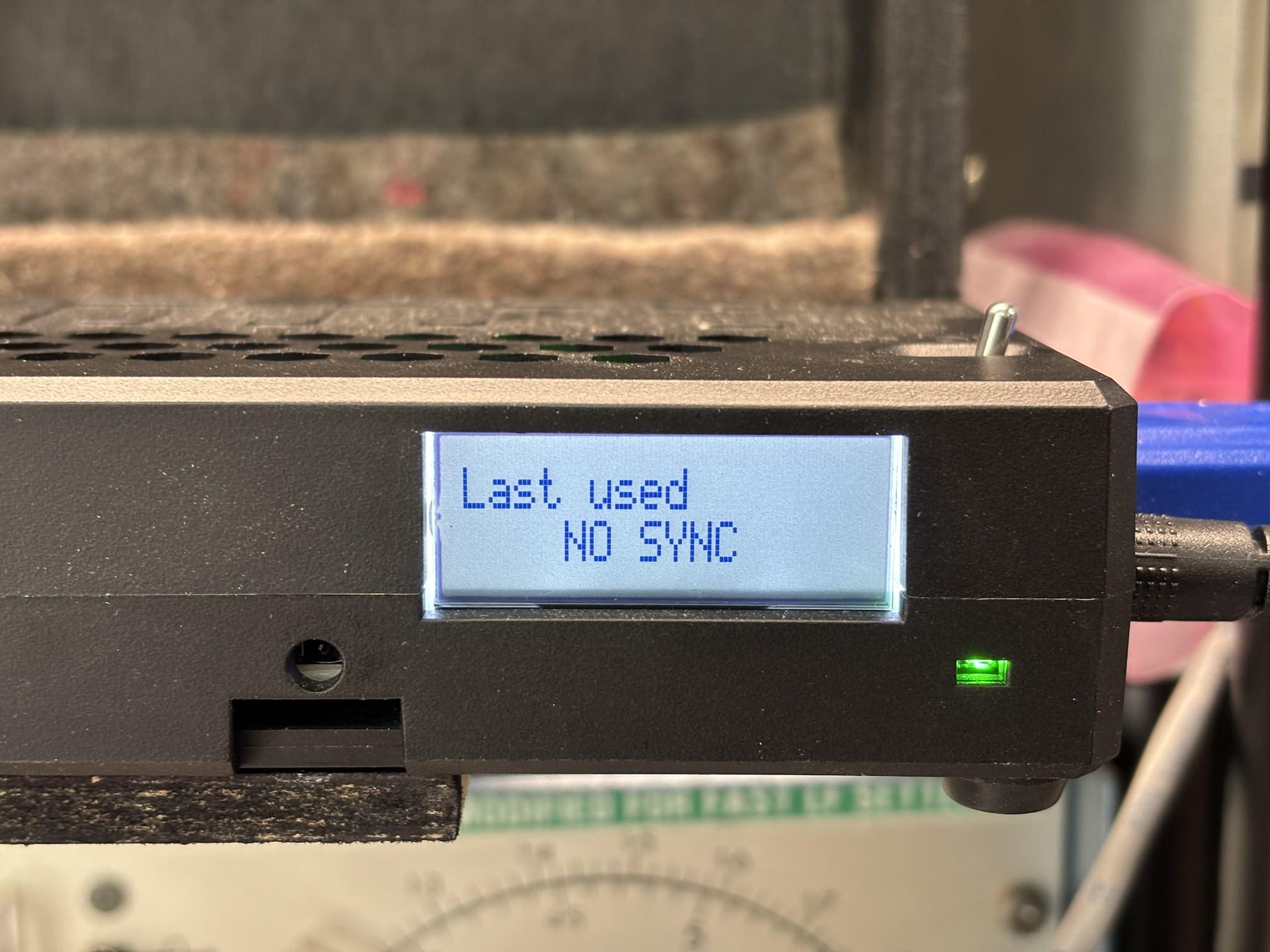

                                  I’ve just flashed 1.21 (thanks @marqs !!) and if I set the power-on input as “last used”, it doesn’t seem to be working.
                                  Upon reboot, the OSSC displays “last used” but doesn’t lock on the input. Every time, selecting AV3 from the remote restores the input.
                                  If I set AV3 as “power on input”, it correctly starts on AV3. I believe I had it on “last used” with my previous FW and it was ok?
                                  Am I doing something wrong?
