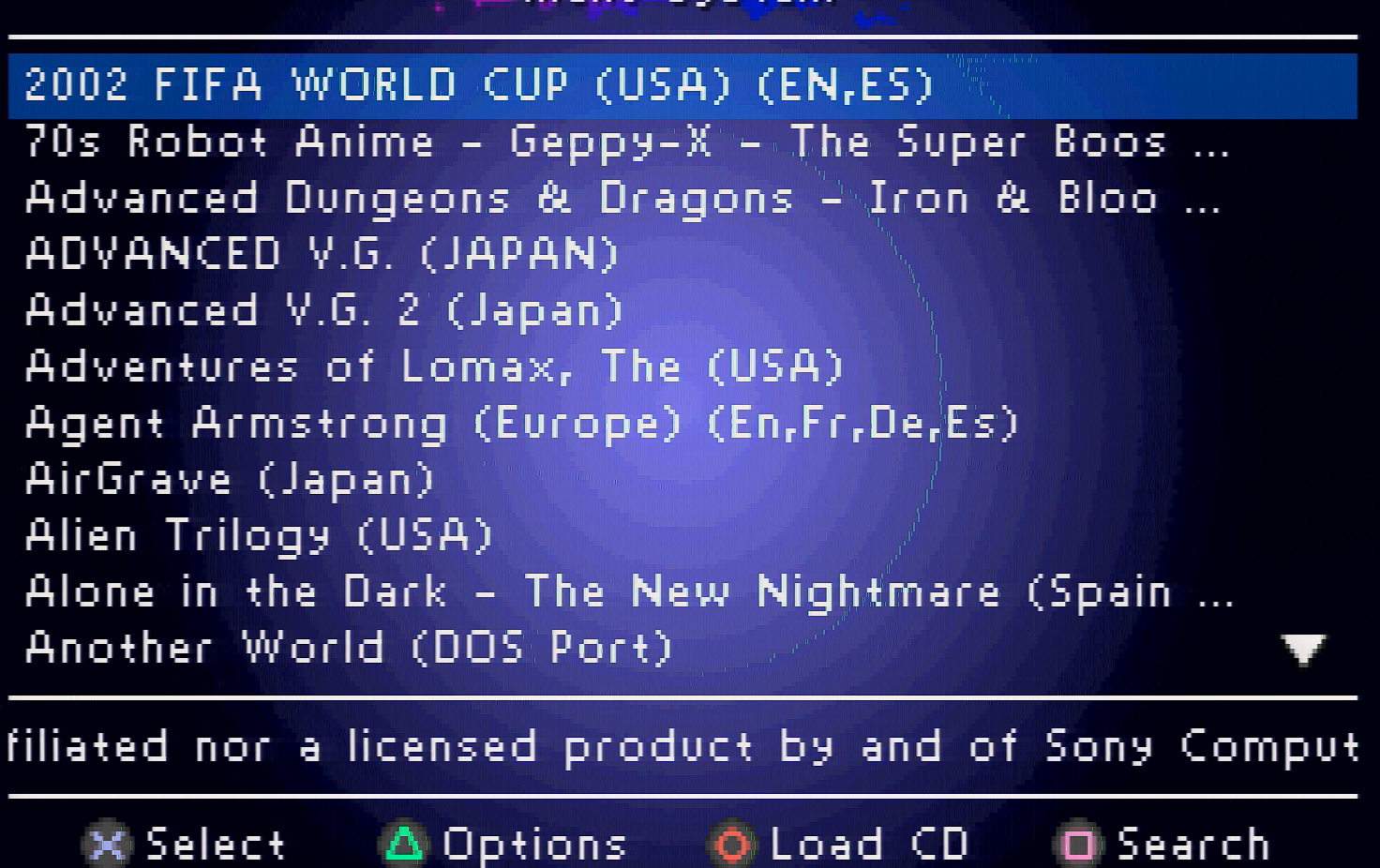

      Hi, I’m having problems with ossc in version 1.6, it’s showing green lines around the image. This problem had already appeared once but it resolved itself. But now it has appeared again, I left a video and an image, if anyone can help I would appreciate it.

        Does that only occur on higher LineX modes or regardless of output mode?

          It’s been happening in any mode, I’ve tested it with component video, scart and vga and in other resolutions. A while ago I had this same problem but after a while it returned to normal without me changing anything, but now I’m having this problem again showing these green lines on some consoles, this is very annoying as it degrades the image a lot
          #62837
            It sounds like a cold solder joint or hold timing violation, most likely former. I’d try some different firmware versions, or RMA if those don’t fix it.
