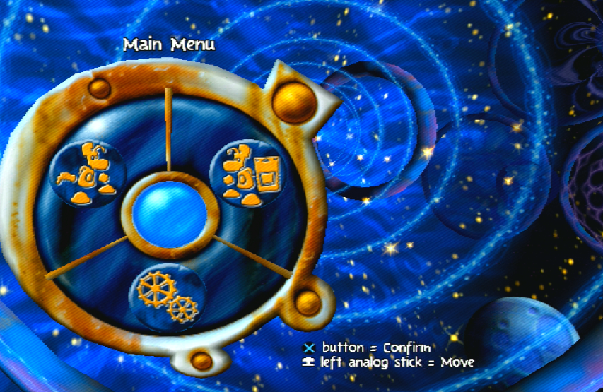

gran turismo 3, i did fix it with a modded memory card, but now in 1080 games have a strange look. that’s the last thing i need to fix

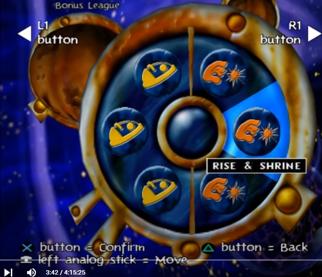

and yes this is rayman M on PS2. the flickering are fixed but i don’t like the view of it, i have a modded ps2 memory card now, and go with 1080, but anyways here is how it should looks like
