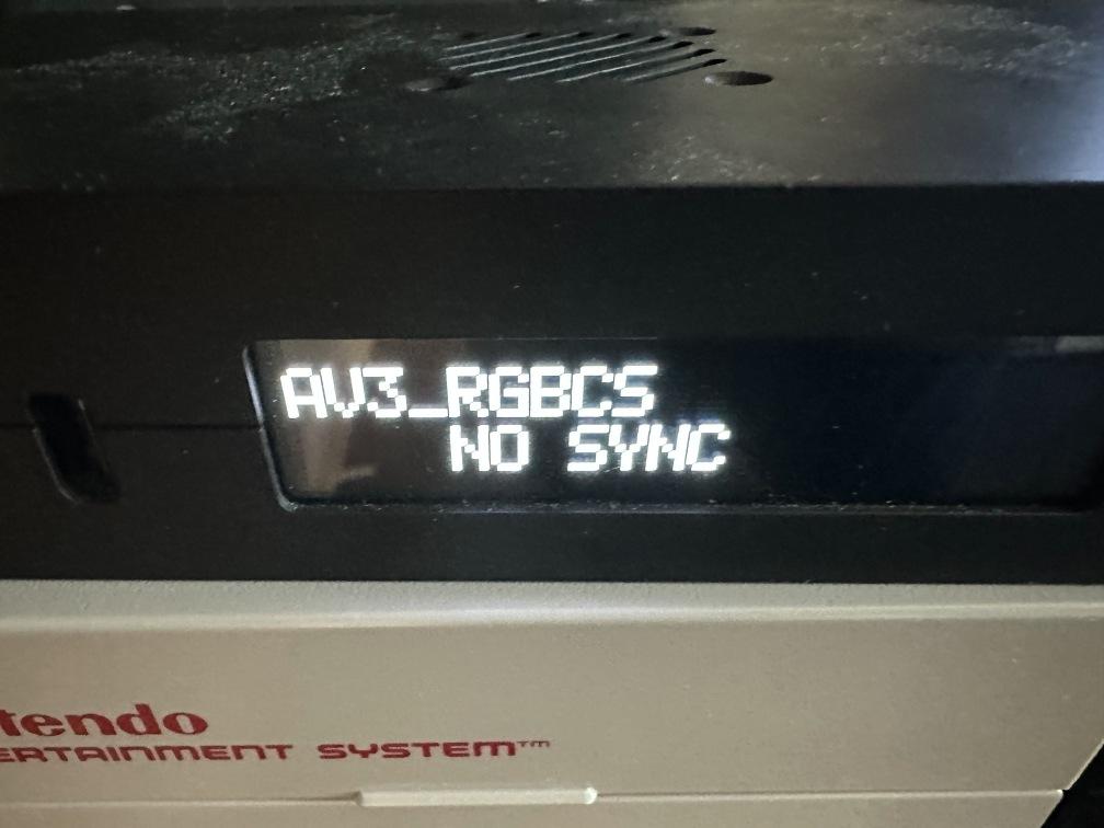

      As in the title.  Firmware is the latest AFAIK (0.78).  It was working fine before, but now it does not display anything on AV3 RGBCS.

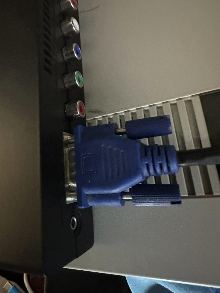

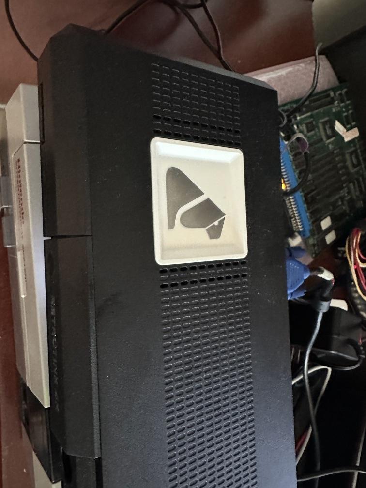

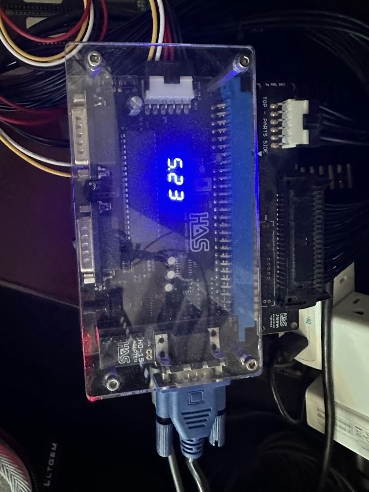

      I tried power cycling, did not help.  Display source is an arcade PCB connected to a HAS, which outputs 15KHz RGBCS over VGA cable.

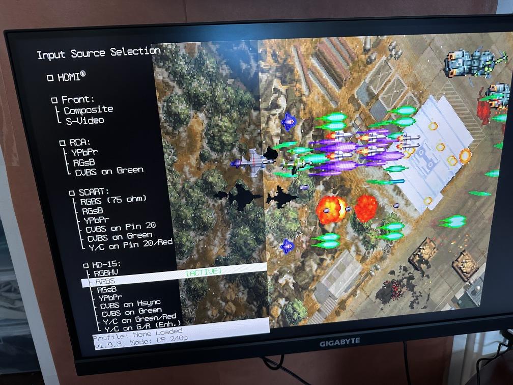

      Exact same VGA cable to Retrotink 4K displays fine.

          I got it working.  I had to switch the jumper on the HAS from 75Ohm to TTL level for sync.
