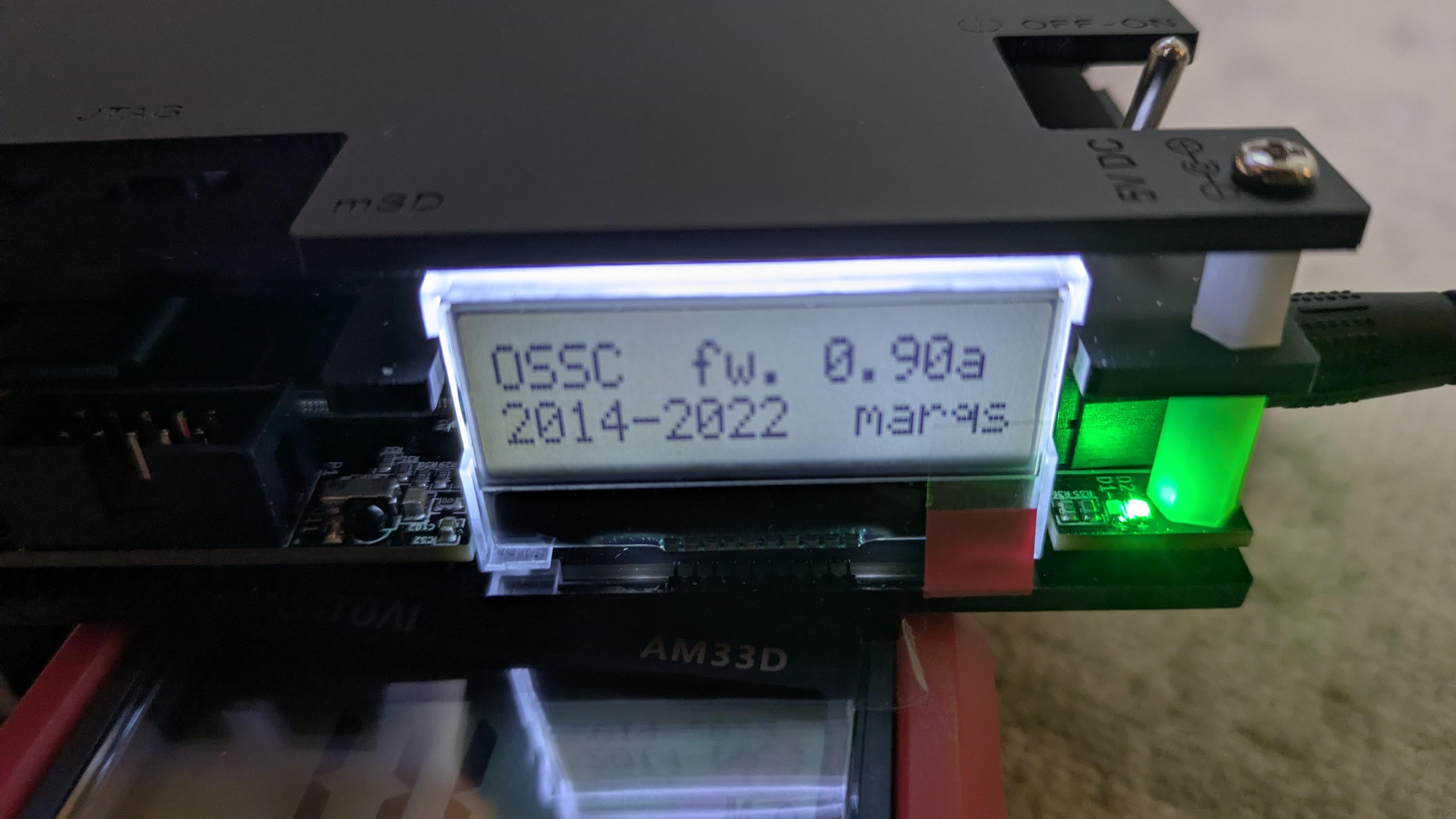

    houmous
      Hi Guys. Using my OSSC with my Wii. It keeps randomly cutting out for a second every minute or so and resetting to the greyscale screen. Can anyone help please? Many thanks!OSSC </p>
      • This topic was modified 9 months, 3 weeks ago by houmous.
      #68277
        Does it do this on any other source or when just left idle on the test pattern?
        #68290
        houmous
          Hi. Thanks for your response. It does it on any source but seems to do it more often when its linked up to the Wii. The timing is anywhere between approx 30 secs and two minutes….
          #68314
            There has been a few similar cases which have been due to bad soldering of the FPGA. Unless you have equipment to fix the cold joints, it’s better to return it to the store you bought it from and ask for a replacement.
            #68325
            houmous
              Hi Marqs. Thanks for your reply. Unfortunately returning it to a store isnt an option. Would you know anyone in the UK who could fix it for me? Many thanks.
              #68343
              houmous
                Panic Over!! It was a faulty power supply!  All working perfectly now 🙂 Thanks for your help…
