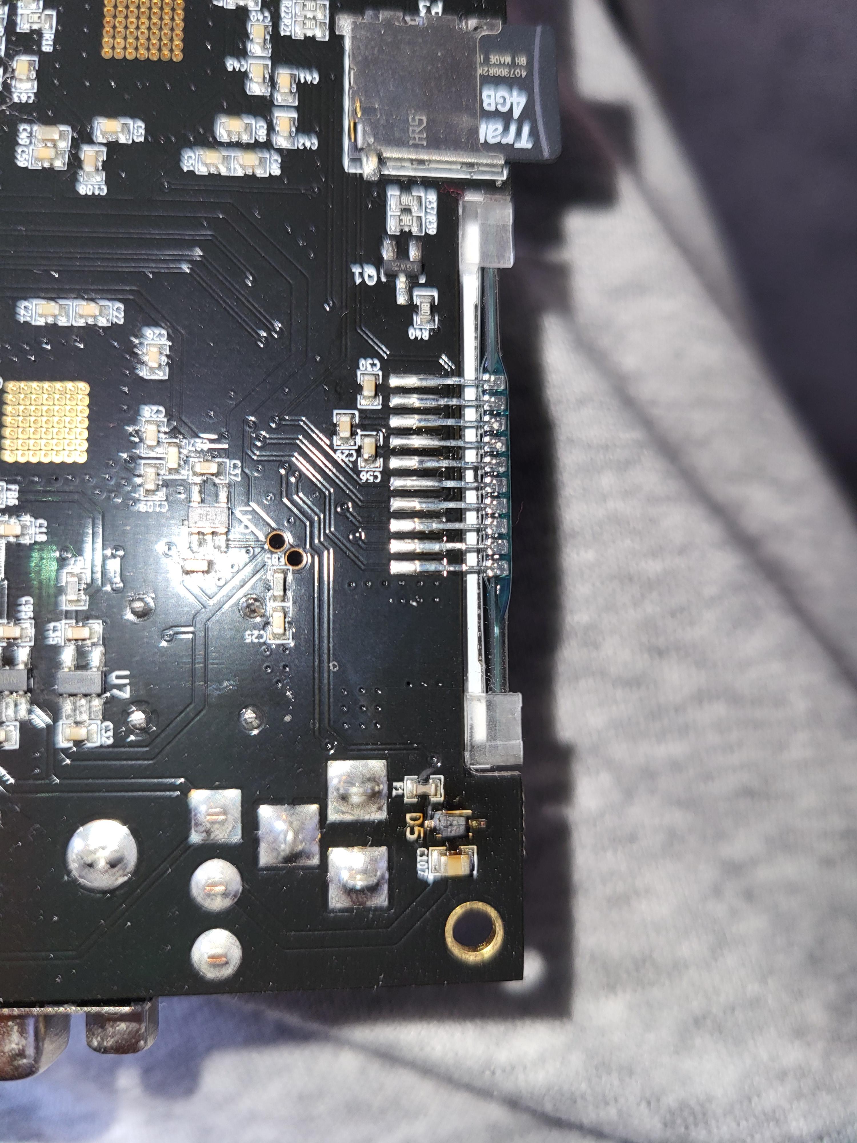

      Just picked up a V1.5 that had a bit of a party with the wrong psu.
      Initial visual inspection, one thing jumped out straight away !!
      Got a hunch that SD05-7 that’s almost split in half needs replacing, may as well replace F1 while I’m at it.
      The cap at C107 is probably fine but just as easy to replace that at the same time.
      RIP D5

          Took a while to get round to this, but… it works !
          Just needed to replace F1 & D5, fortunately no other damage was done.
          Think I’ll do the resistor mod and update the firmware next.
          Really pleased to get it working at last.
