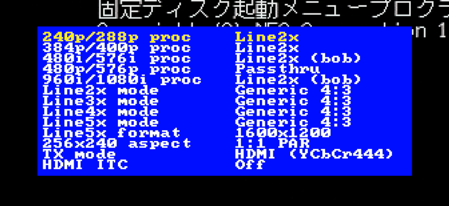

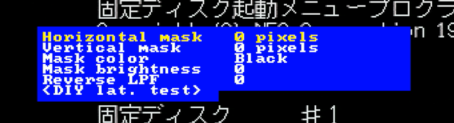

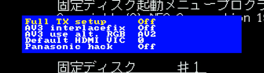

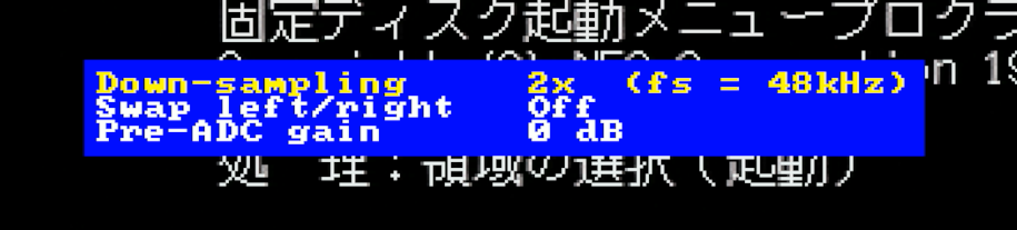

      Hi, i have a real PC-98 hooked up via BNC (https://krugman.net/ossc/) to the OSSC to an Elgato HD60S+ into my PC running OBS 32.1.2 on Linux Bazzite.
      Here is a showcase video of how laggy the input it. I know i can have many reason. I believe OBS and the Elgato aren’t Problem as they work fine with other devices (like a PS5) and the PC-98 also runs fine on a regular (albeit old) monitor:
      https://streamable.com/7pqghi

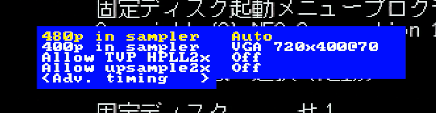

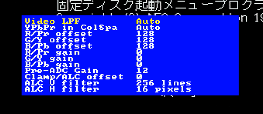

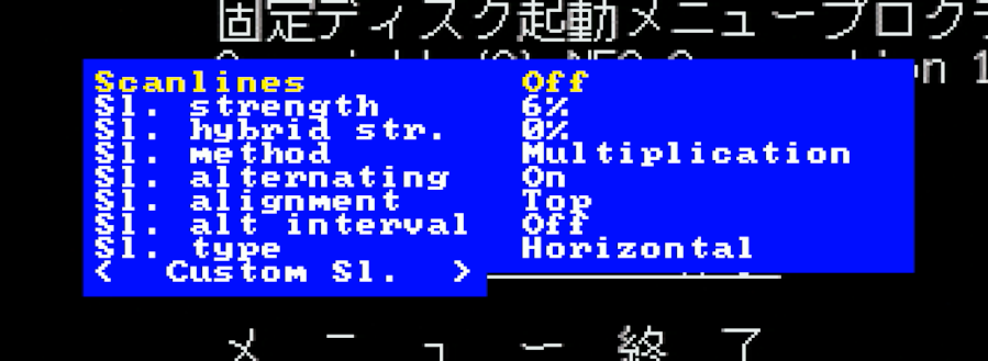

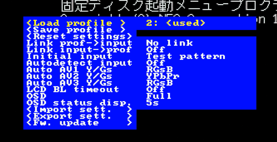

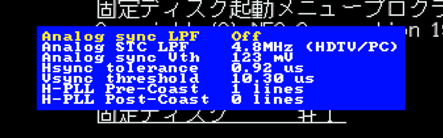

      And here are all my settings. Any help or suggestions are appreciated.
      If I should post any other information, please let me know. I’m not a total noob to this, but I am also far from an expert. 🙂
      Cheers

        Does the capture card properly support 55Hz sources and is capture framerate adjusted accordingly?
        #69577
        jdmx
          Figured it out. Was a “fake” USB3-Cable…. extra got a different card (Elgato HD 60 X) to test it. didn’t work on either with the fake cable, worked on both with a proper usb3 cable….
