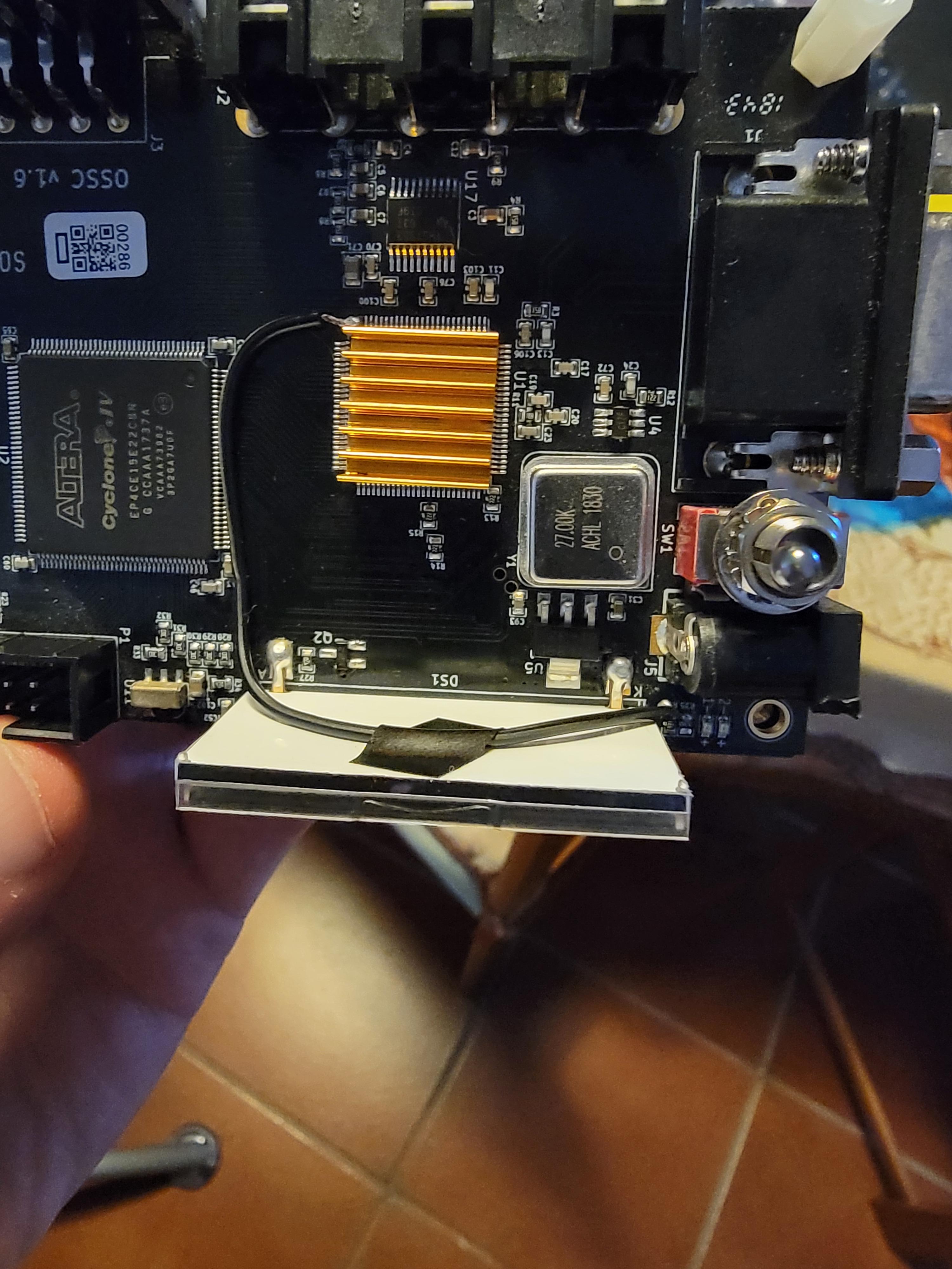

      So i was able to successfully mod my 1.6 rev to be able to use the new firmware, I have to say removing that r35 was a pain it’s so tiny! (anyone have a tip for something so small incase i have to do something similar in the future?)

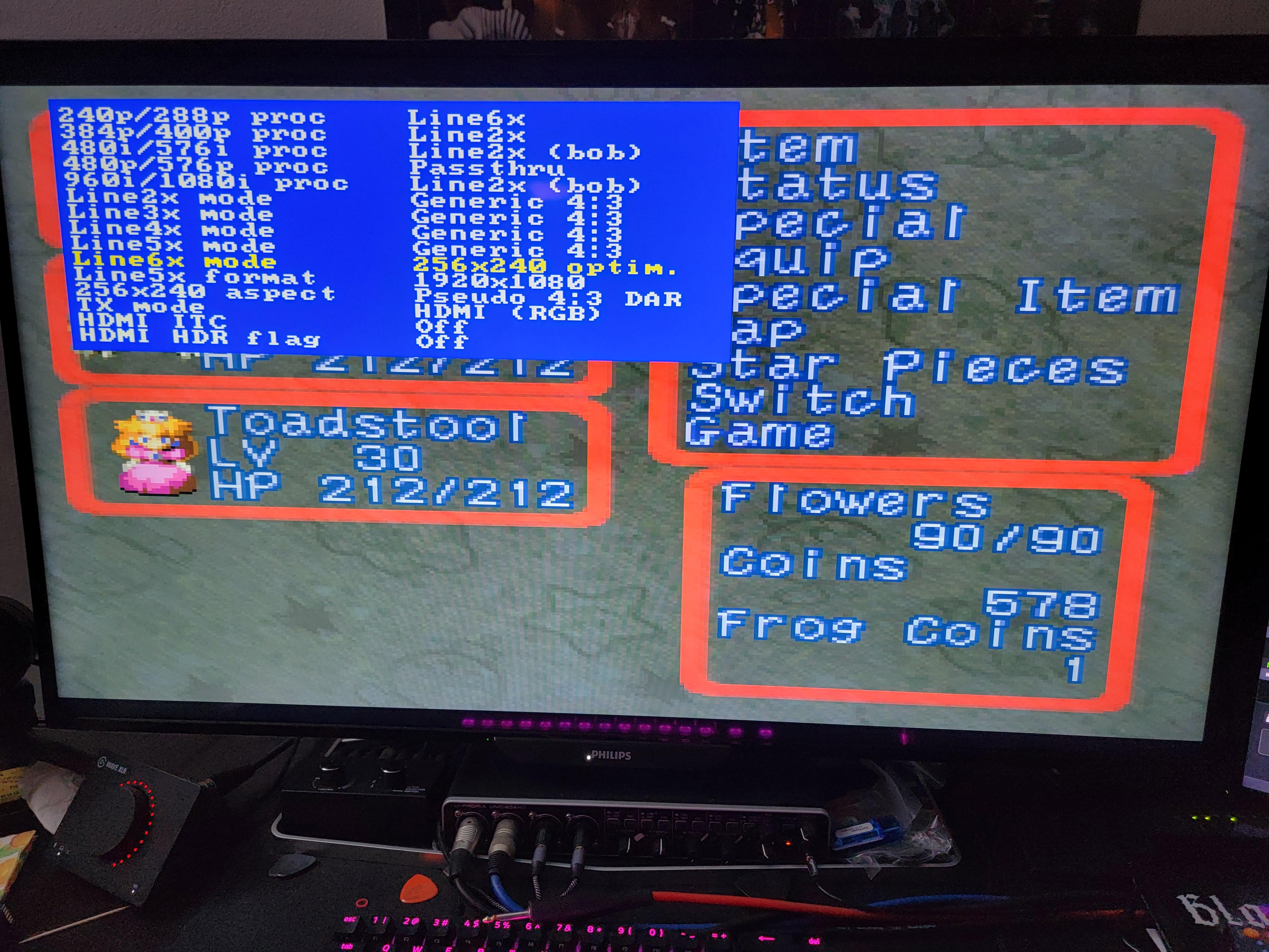

      Anyways my question is. Is there any setting I can change in the OSD to make linex6 display at 4:3 instead of 16:9 for the non optimzed modes?

        You should set 4:3 aspect ratio from the monitor for 1920×1440 input.

          I had a feeling this would be the only solution. Thanks for responding.
