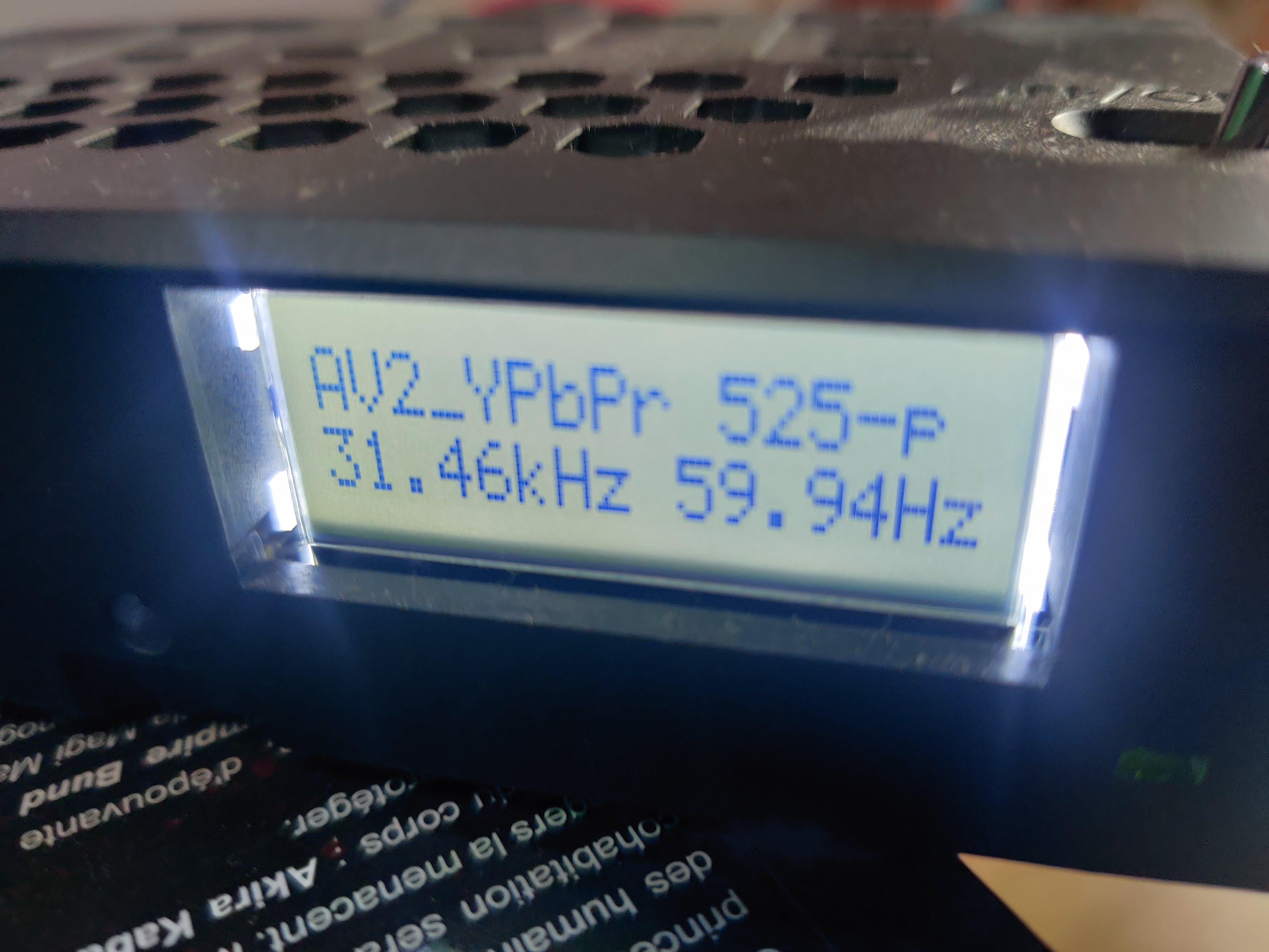

      * Does OSSC show sync information on its character display, and is red LED turned off? If sync info is shown, please include that in your report along with details from info screen (accessed by pressing INFO on the remote).
      Yes, there is SYNC information on the character display and the red LED is turned off… see screenshots below. I don’t know whether a video showing what’s happening could be useful…
      OSSC Character Display
