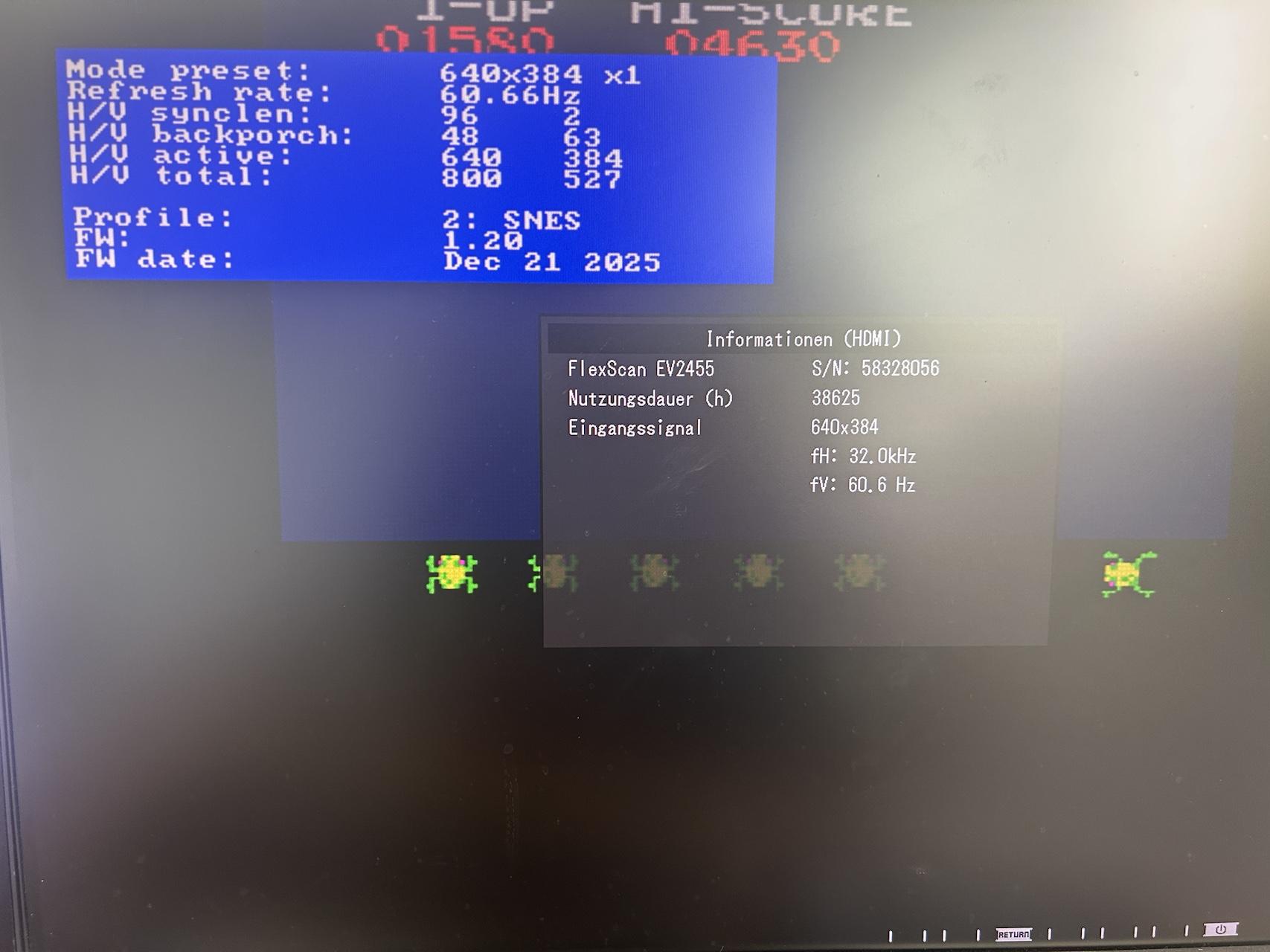

      Hey guys,

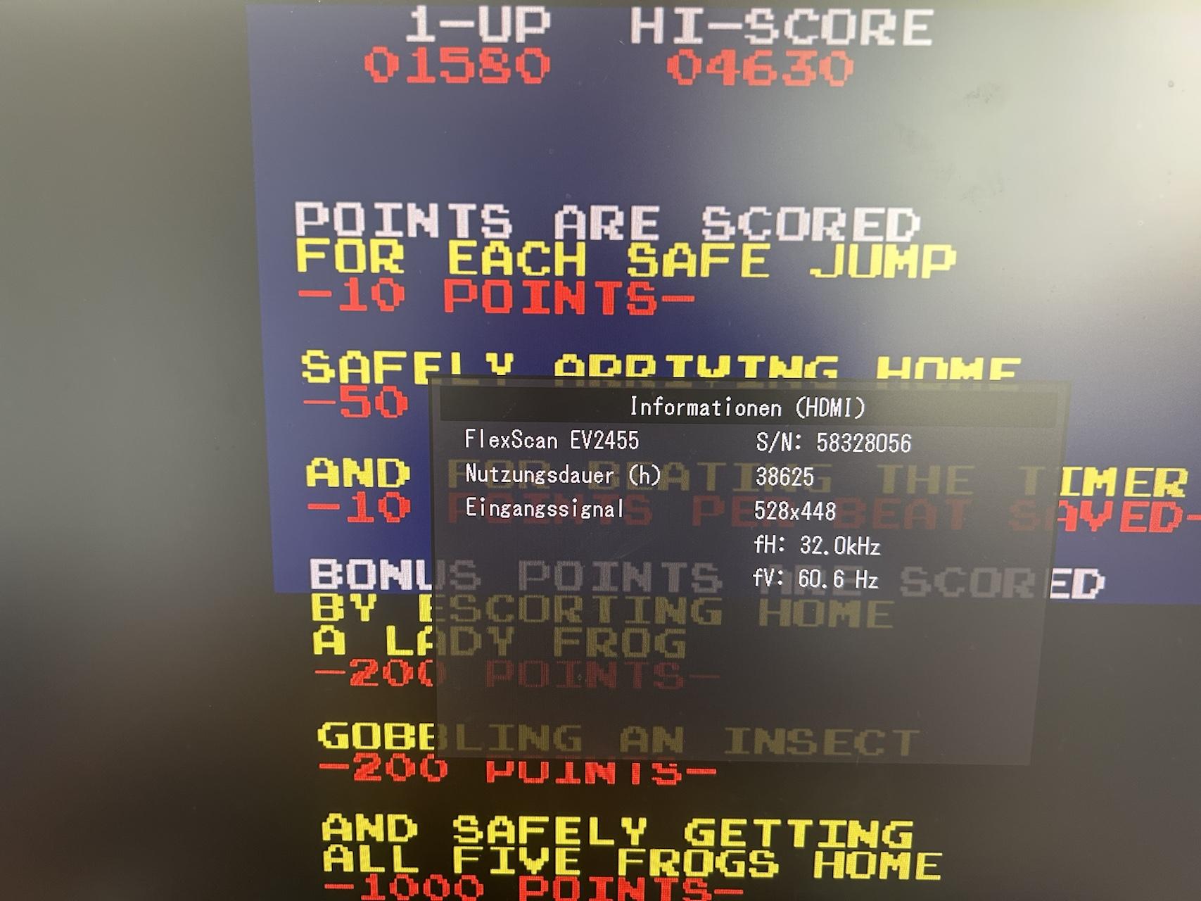

      I’m trying to display my scandoubled output from SiDi128 (YPbPr). This is a Arcade-Core (Frogger), rotated clockwise from vertical. When connecting the Sidi128 directly to Monitor, it will show resolution  528*448. When connecting to OSSC it chooses preset 384p. Is it possible to switch this to 480p?
      When using non scandoubled output from Sidi128, I’m able to shape the picture…. but without active scandoubler in SiDi128, the rotation option is not available as it is part of scandoubler-module 🙁 Image going direct from Sidi128 HDMI
      Passthrough Routing with OSSC

        Can you try resetting the settings? Normally 640×384 preset shouldn’t get selected for source with such timings. There are also fixes in fw 1.21 which might be related if you’re loading profiles from SD.
